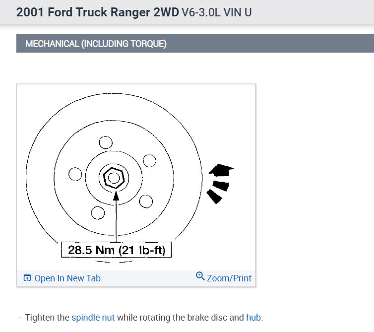

What is the proper procedure and torque values for installing/tightening the front wheel spindle nuts?
2001 FORD RANGER
246,000 MILES • 3.0L • V6 • 2WD • AUTOMATIC

Front wheel spindle nut torquing procedure/values needed.

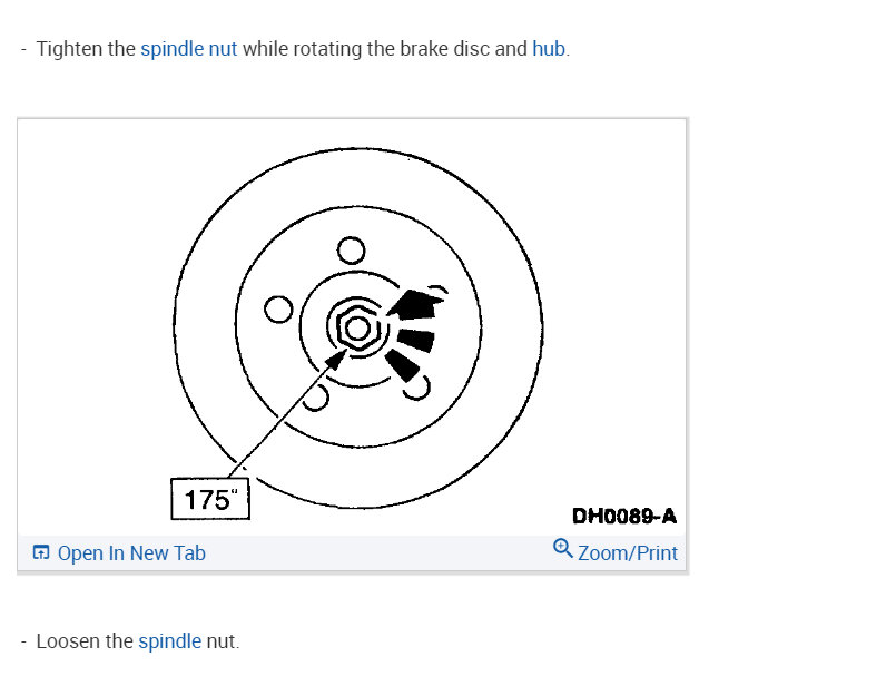

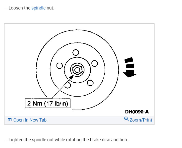

Do you mean the rotor to spindle nut? If so, here are the instructions in the diagrams below. Please let us know if you need anything else to get the problem fixed.

Yes, the rotor to spindle nut was what I was referring to. Thank you. An automotive shop told me that the front wheel bearings needed repacking which is why I needed to know the torque specifications.
