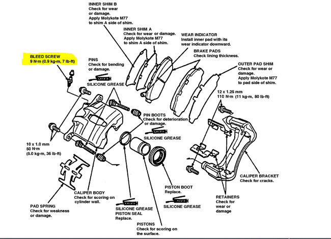

Like the others, I'm not sure what a nipple would be on the drive wheel would be, but what you described sounds like you have a brake caliper that is slightly hanging up and causing excessive heat to be produced at that wheel. When this happens, have you ever noticed excessive heat from the wheel in question?
What can happen is this. If there is a drag on the brake at the wheel, it will produce more heat than is desired. Excessive heat causes brake fluid to expand which will cause the brake to slowly apply itself. That would explain the difficulty of accelerating. The vibration you get is simply from the rotor being overheated and under pressure.
When this happens, has anyone lifted the front wheels off the ground to see if one of the wheels won't turn? If not, that is what needs to be done.
Now here is where I'm questioning what may have been mentioned to you. If there is a wheel that won't turn, you can loosen the bleeder valve to see if it releases pressure. (perhaps the bleeder is what you are thinking was referred to as a nipple). If it does, then we know it is overheating and causing the issue. At that point, we would need to determine if it is related to a caliper that is partially stuck or if the rubber brake hose is failing.
I don't know if that makes sense, but I believe this is what is happening.
Let me know if you have questions. Also, let me know if you ever noticed excessive heat, an odd smell, and as much as you can think of that may help me.
I attached an exploded view of the brake caliper for your vehicle and highlighted the bleed screw. I suspect this is what you are referring to. By the way, replacing that would not fix the issue. However, it will be used to determine if the problem is at the caliper or a different component. Also, it could be referred to as a nipple.
I hope this makes sense. LOL Let me know.
See pic below.

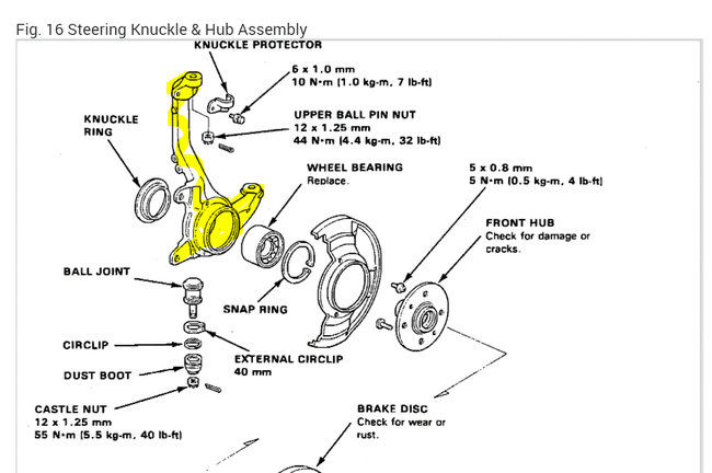

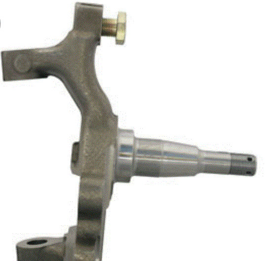

There is a spindle and a steering knuckle. If it had to do with the spindle, chances are it was the wheel bearing that was replaced. Does that sound familiar? The wheel bearing is pressed into the steering knuckle.
I can't see how the steering knuckle in and of itself could cause these symptoms. However, the wheel bearing which the axle spindle rides, could. Does any of that sound familiar?
On a non-FWD vehicle, the spindle is part of the steering knuckle. See pic 1.
On your vehicle, the front-drive axle pushes through the wheel bearing which is located in the steering knuckle, and it is secured with a spindle nut. In my mind, that portion of the axle functions as the spindle. see pic 2. I highlighted the knuckle on your vehicle. Note there is a spindle nut in the pic, but the axle isn't shown. That nut secures the axle to the knuckle.

That is correct. In this case, the spindle is the end of the CV axle. As far as the knuckle, I doubt there is anything wrong with it. It is likely the bearing itself.
On a front-wheel-drive vehicle, there isn't a traditional spindle that is part of the knuckle.
