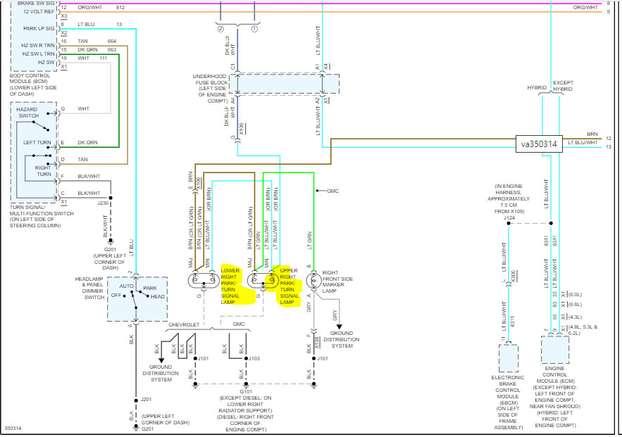

When the truck is off, the light switch is off, the front right turn signal stays on at all times running the battery dead unless I disconnect the battery. When pulling the running lamp fuse for the front right lamp, it still stays on (Fuse 27). I noticed that fuse 25 is blown at this point, which I believe is the trailer running light fuse. Unplugging the headlight does not change the issue. All other exterior lamps work as they should except for the passenger mirror which pulsates dim and bright.

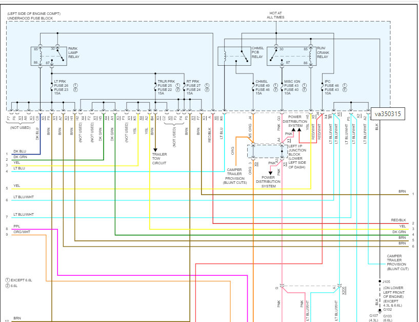

I just looked at the wiring schematic related to the exterior lighting. You indicated if the fuse is removed for the right side brake/signal that the lamp stays on, correct? Also, are both signal bulbs in the front staying on?
Sorry for so many questions. I'm trying to narrow down where there could be a short. Have you tried removing one fuse at a time to see if there is one fuse that turns the light off?

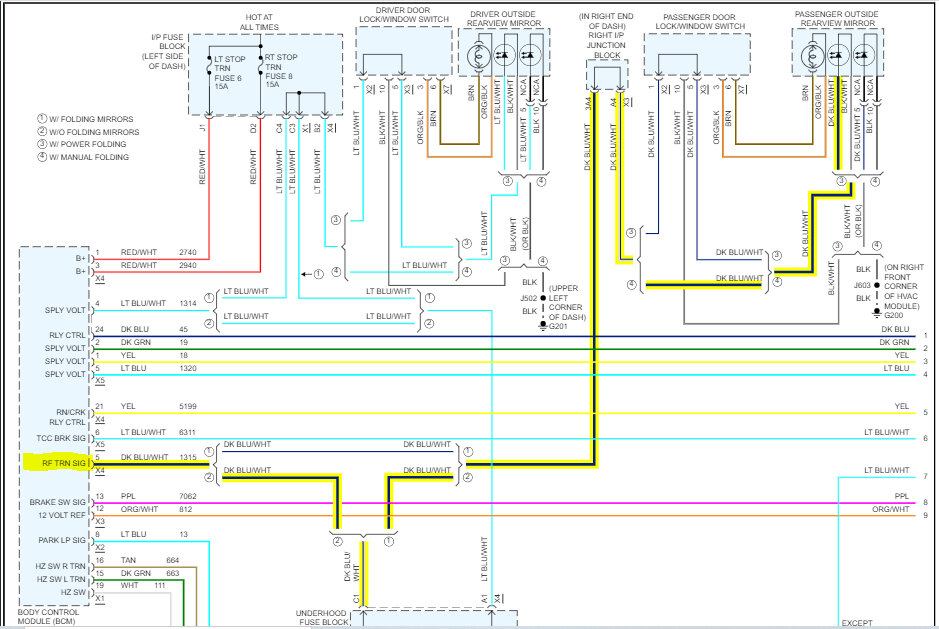

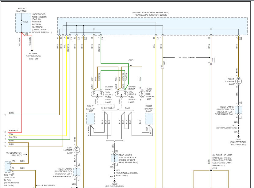

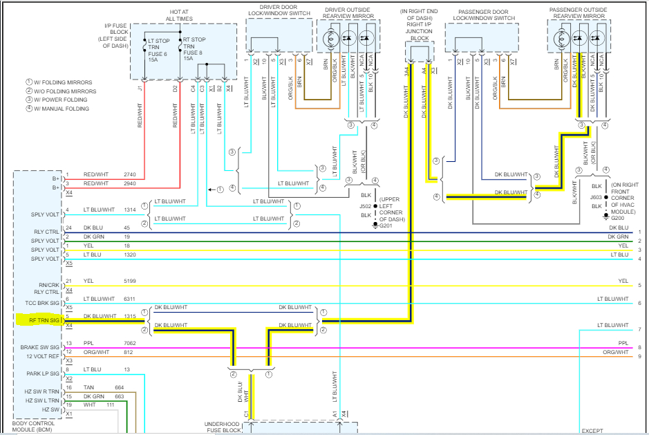

If you look below, power to the signals is sent by the body control module. There could be an issue at that point with a short in the connector. I attached the schematic so you have a reference.
Let me know as much as you can that may be helpful.
See pics below. Note: I had to cut the pic in half to make it readable. I did overlap them so you can follow from one to the next. Additionally, I highlighted the related wiring.

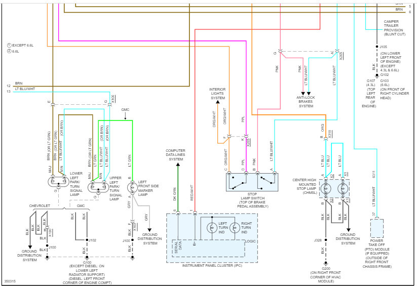

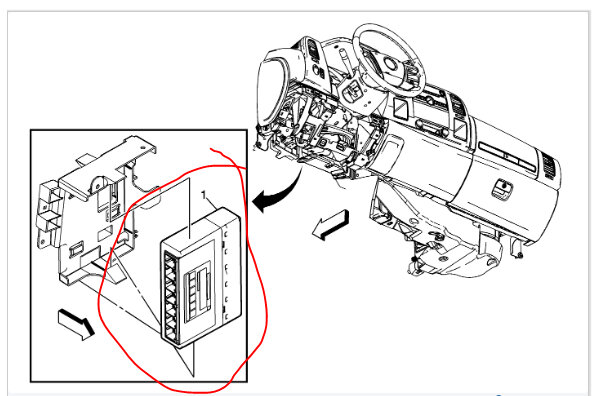

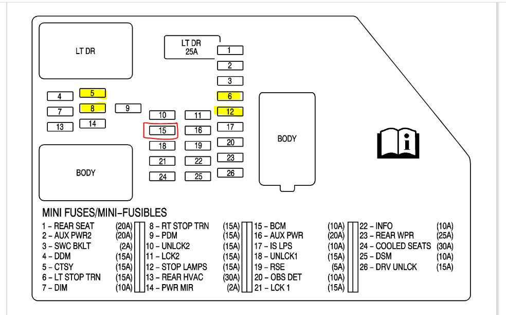

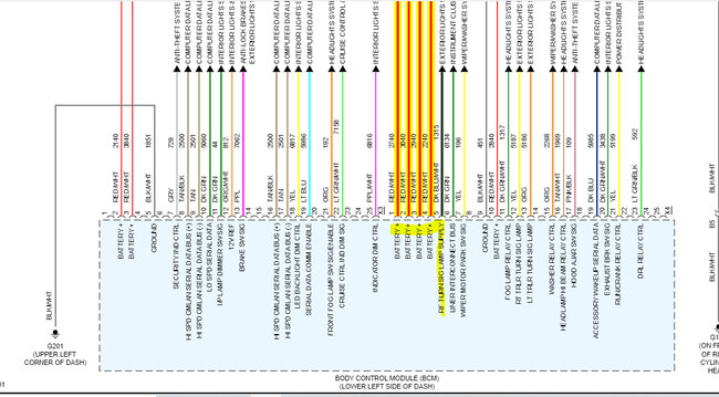

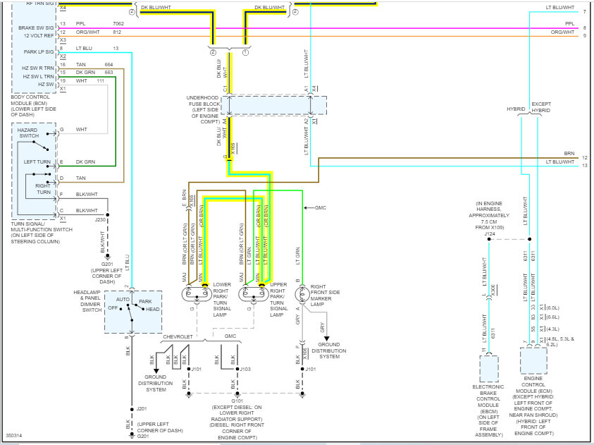

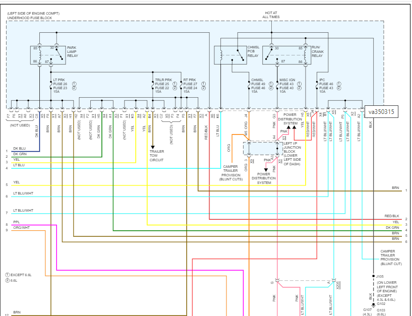

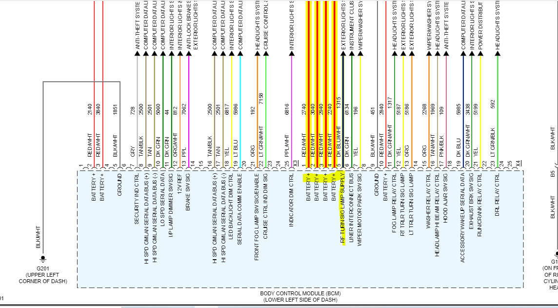

I'm trying to narrow things down. The body control module has a role in both the headlamps and signals. It is located under the left side of the dash. See pic 1.

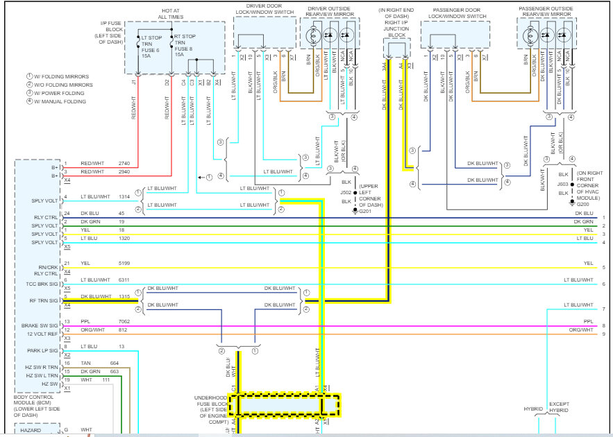

Pics 2 and 3 are a schematic from the BCM. Note that the right signal power supply signal is right next to several wires that provide power to the BCM directly from fuses. You may have a short there.

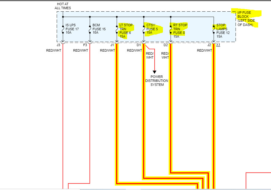

I need you to remove (one at a time), the fuses I highlighted located in the interior instrument panel fuse box. See if any of them turn off the light. If they don't, that eliminates the fuses/connector. At this point, you will need to disconnect the BCM and check the pin for the right supply signal for power with everything off. If you have power and everything is off, chances are the BCM has failed.
One last thought. In the last pic, I show the fuses to check in the vehicle. I circled the BCM fuse. If none of the other fuses make a difference, pull the circled one to see if that changes things.

I went ahead and pulled fuses 5, 6, 8 and 12 one after the other checking each time and the light never goes off. I pulled fuse #15 and the light didn’t go off. Lastly, I completely unplugged all of the BCM connectors, and the light never once turned off. Sounding like a short to power still. Just have no clue where to look from here.

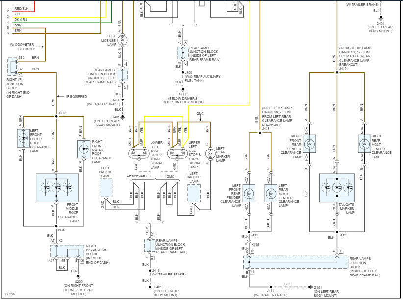

We have two ways to go with this. One is to start at the power supply wire at the right front headlamp connector and trace it back until you locate the cause. Or replace the box. If the box is replaced, there is no guarantee it will fix the problem.
I attached the entire exterior lighting wiring schematic below for you. It is time-consuming, but if you decide to trace the wire, you can use the schematic to help. The schematic is three pages long. To make it readable, I had to cut each page in half, but I did overlap them so you can follow from one to the next.
Also, does this vehicle have a factory tow package or power mirrors? If it does have a tow package, disconnect the wiring to the connector in the rear of the vehicle. There could be a short there as well.
Let me know. I realize we are jumping around, but there are several possibilities.
joe
See pic below.

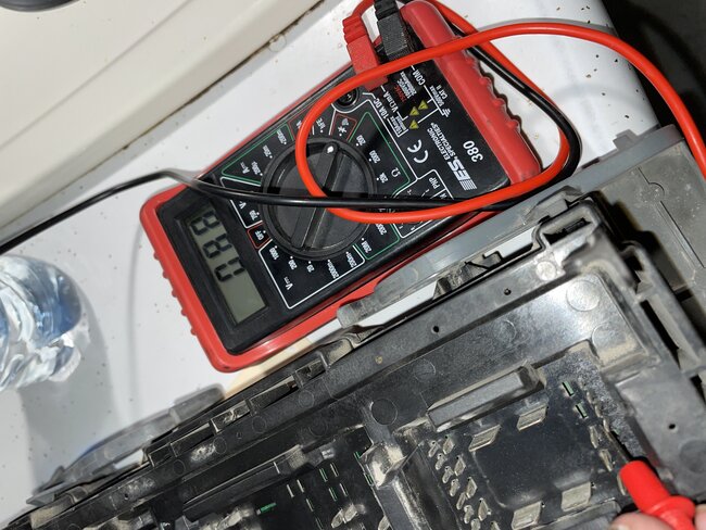

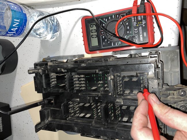

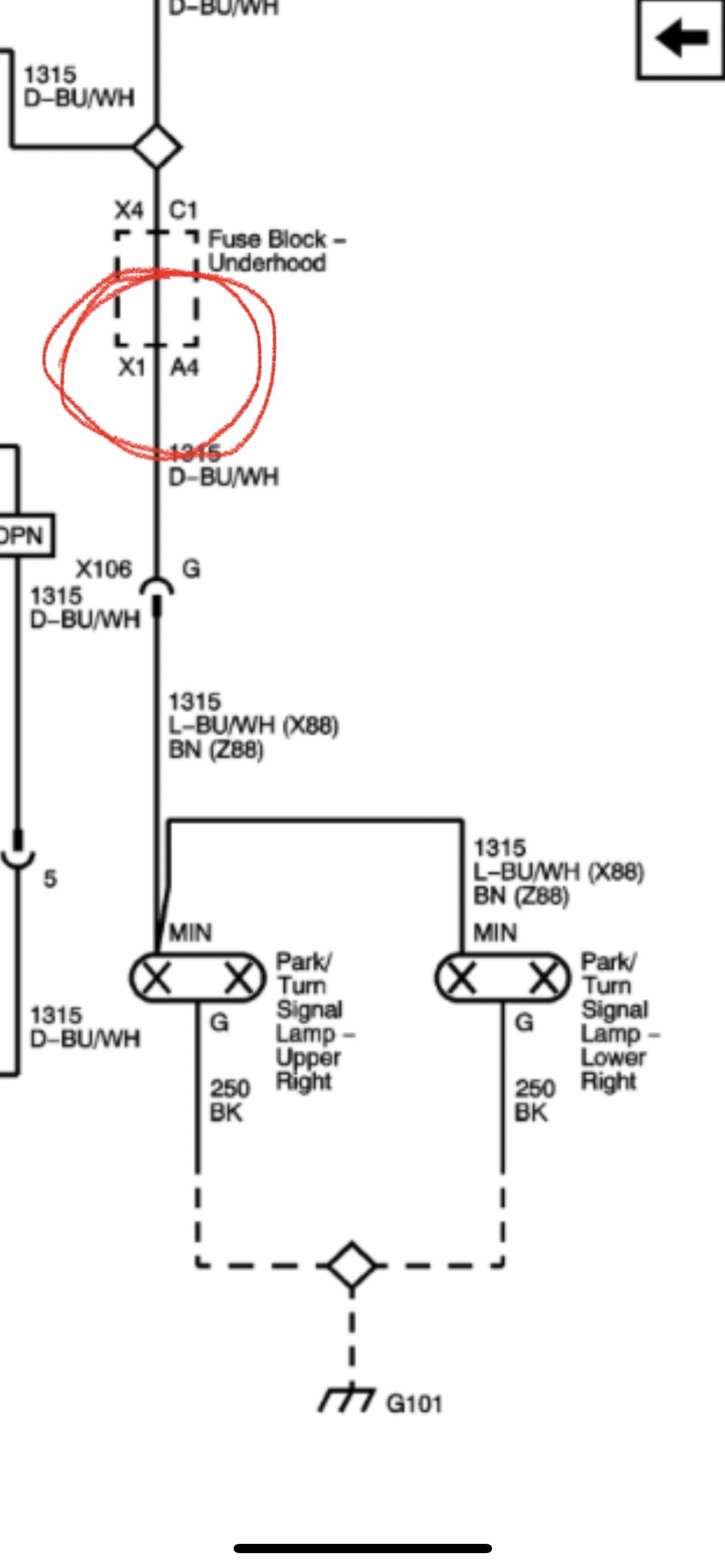

So, I think I figured it out. With the battery hooked up and all of the connectors on the bottom of the fuse box disconnected except for the X1 connector which has the dark blue with white stripe wire for the right front turn signal. I ran a power wire directly from the battery and touching the main buss bar on the bottom turns the light on. I have attached some pictures showing that pin A4 is shorted directly to the main buss bar.
+1
Monday, February 20th, 2023 AT 4:34 PM
BRNSCHR
  • 11 POSTS
Also forgot to mention. I verified the fuse box is shorted internally as pin A4 has continuity with 32 other pins on the bottom of the fuse box.
Monday, February 20th, 2023 AT 4:49 PM
  • 110,192 POSTS
That is the problem. That is where the constant power is coming from. Ugh! Have you gotten a new box yet?
