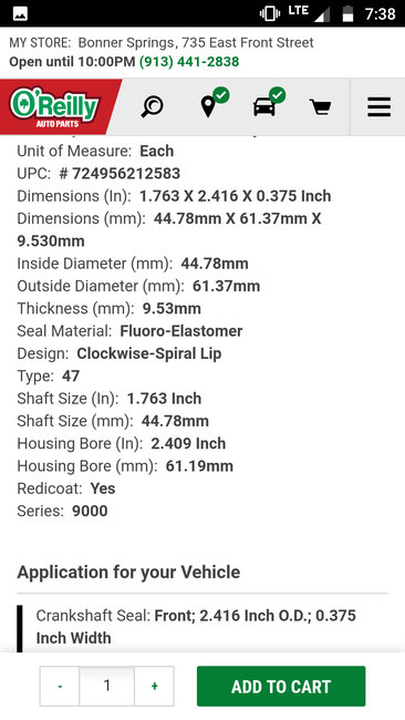

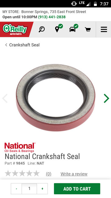

Will this one work?
Apr 23, 2018 at 5:41 PM
Okay, your picture would not enlarge for some reason.
I attached a picture for you of one from Rock Auto. it has to have the lip on the seal.
https://www.rockauto.com/en/catalog/saturn,2008,vue,3.5l+v6,1440282,transmission-automatic,torque+converter+shaft+seal,8656
Apr 23, 2018 at 5:47 PM
Okay, looks to be the correct seal. The one I found had a lip that bottoms out when installed but this will work.
