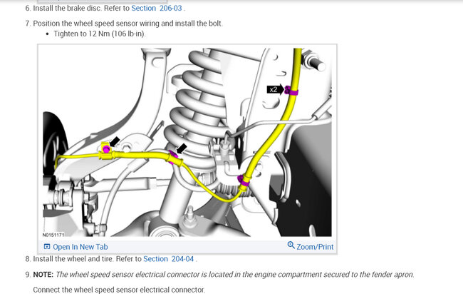

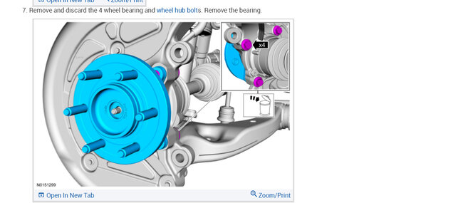

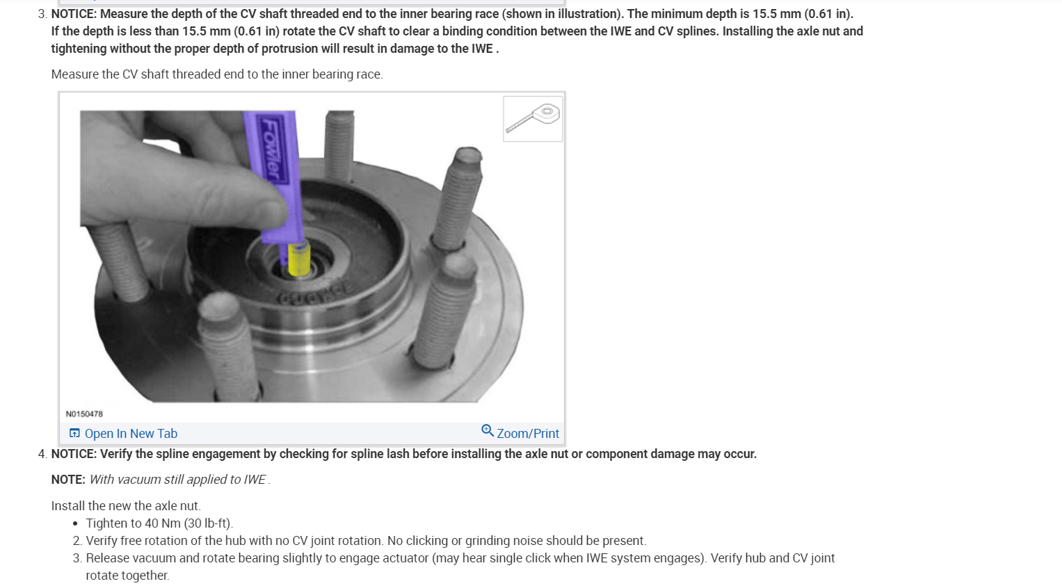

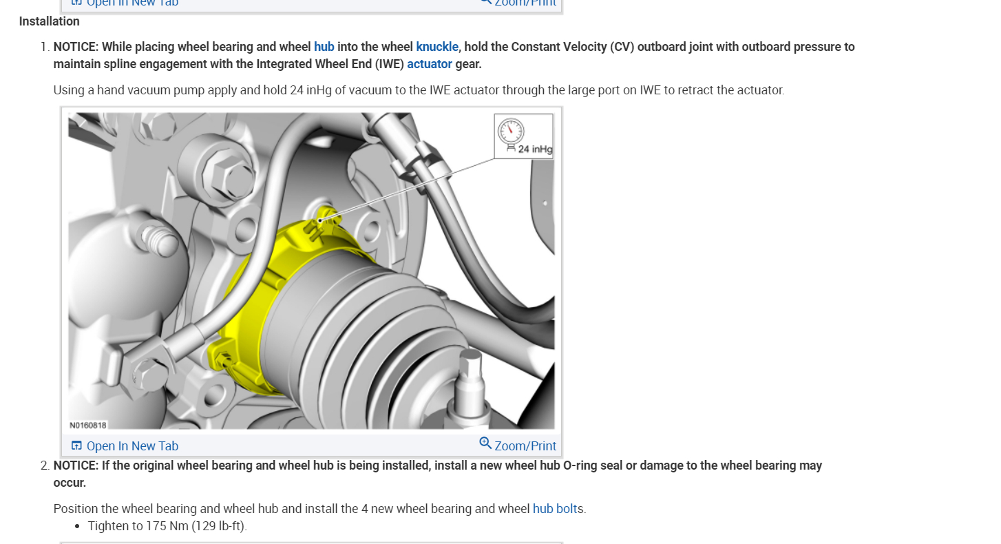

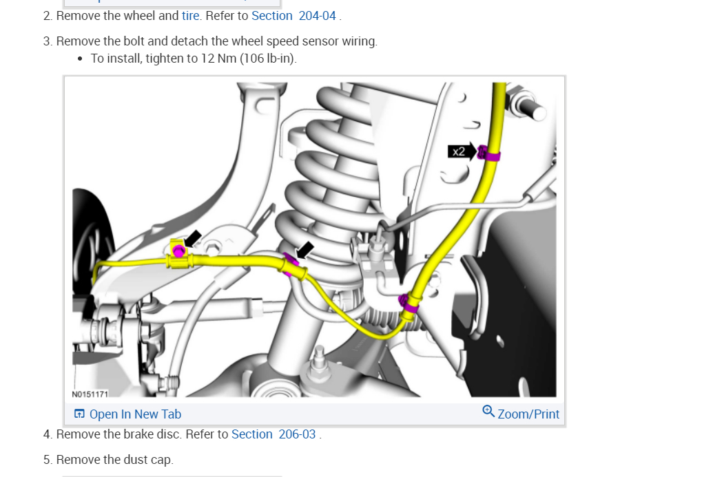

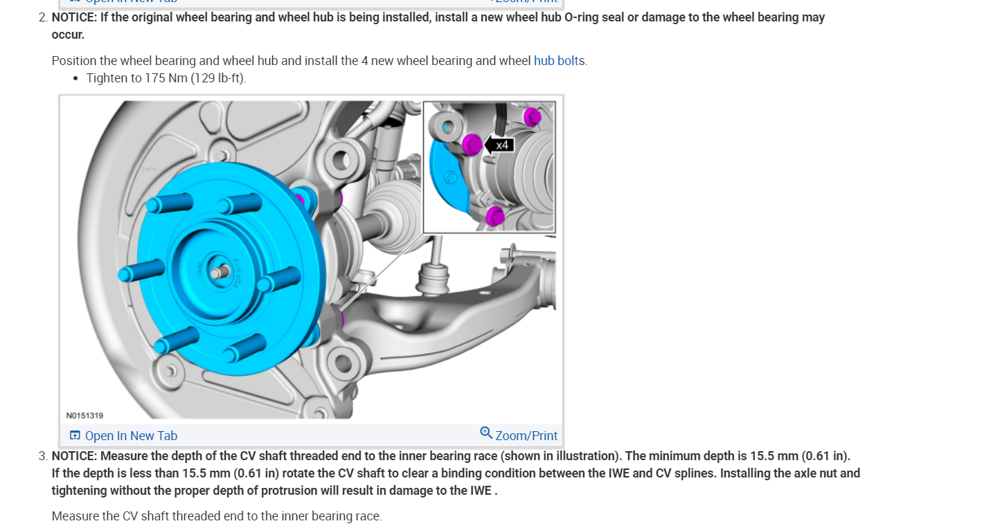

Yep, the bearing hub sounds like it is bad which is common, here is how the hub is replaced in this video below and I have giving instructions on how the job is done as well in the images below. The year is not the same, but the procedure is.
https://youtu.be/qOAyXfPo7Z0
Once the bearing hub of off you can see if it is the problem. Check out the images (below). Let us know what happens and please upload pictures or videos of the problem so we can see what's going on. Please let us know what happens.
