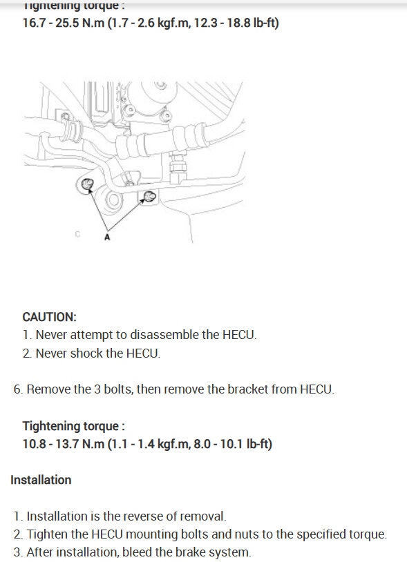

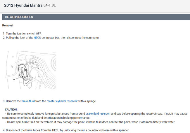

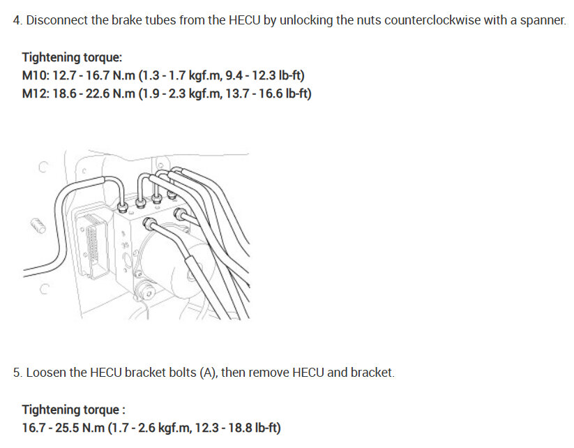

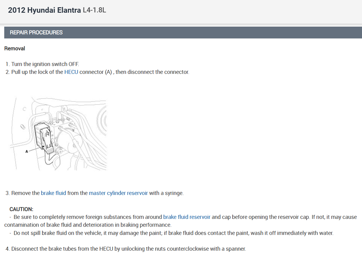

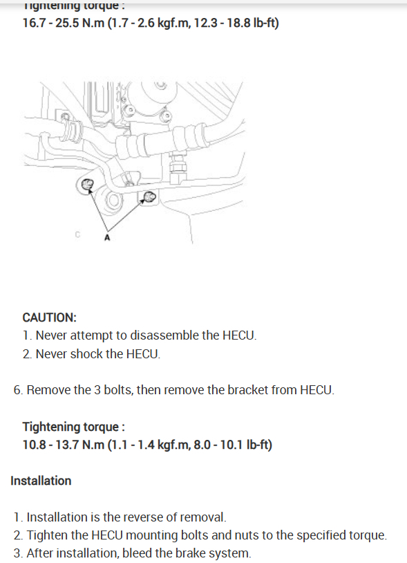

No problem, hits happens when the ABS control module needs to be repacked, here is the location and how to do the job, also this guide can help as well:
https://www.2carpros.com/articles/a-comprehensive-guide-to-fixing-automotive-brakes-locking-up
Check out the images (below). Let us know if you need anything else.
