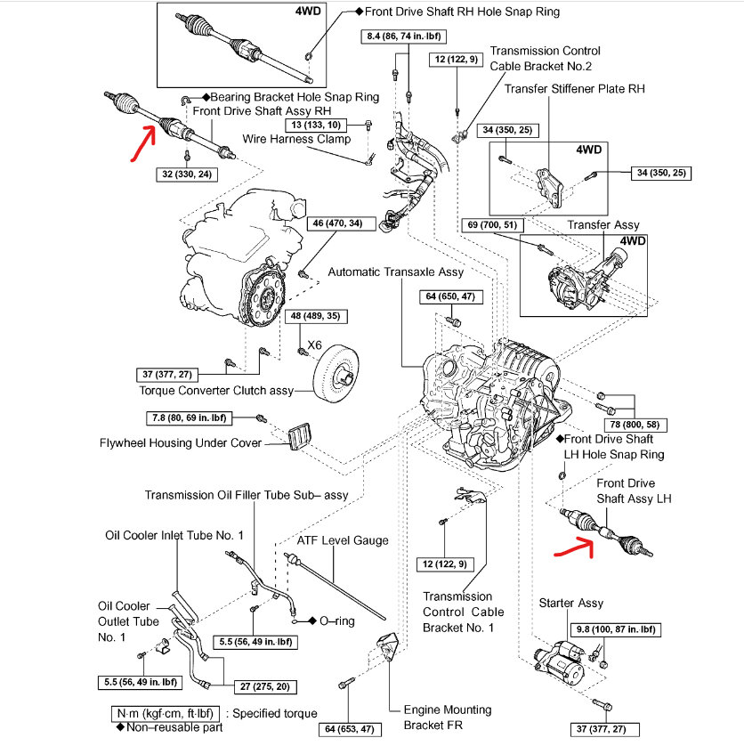

When I'm speeding up, between 35-60mph, the front-end wobbles. What might be the issue? I've already had the alignment and tire balance checked.

Yep, this happens when the CV axles wear out, I would replace both of them. Here is a generic guide to help you step by step with instructions in the diagrams below to show you how on your car.
https://www.2carpros.com/articles/replace-cv-axle
Please go over this guide as well:
https://www.2carpros.com/articles/symptoms-of-a-bad-cv-axle-joint
Check out the images (below). Let us know what you find.

Changing the grease will not help, the CV axles will need to be replaced to fix this problem sorry.
