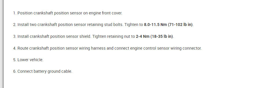

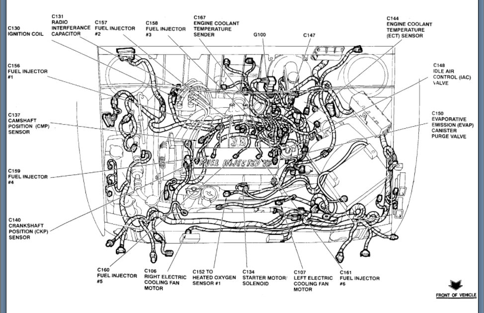

Does a crank shaft sensor have anything to do with my van turning over but not starting?
Sunday, October 3rd, 2010 AT 10:21 AM
MECHANIC
18,907 POSTS

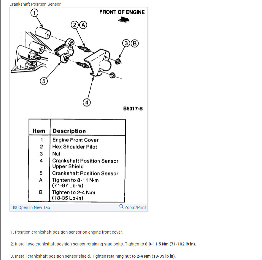

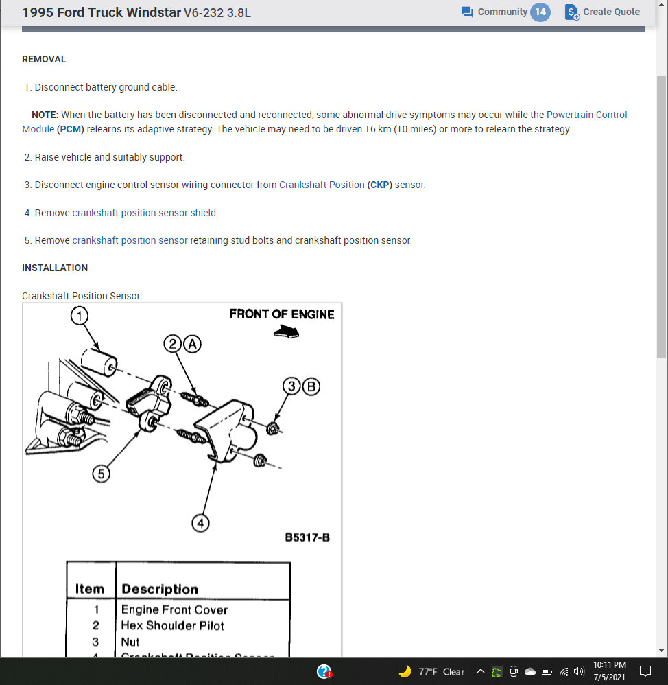

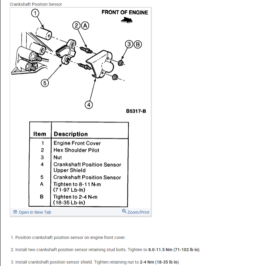

Short answer is yes it does. The starter will turn the engine over but the ECM needs to know engine position in order to fire the plugs and injectors.
Here are a couple guides that will help with more info on this:
Below is the process from the manual that will give the detail needed in order to replace it if needed.
Please let us know if you have other questions. Thanks
