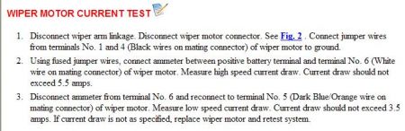

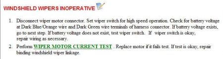

its not the motor, fuse or switch and i dont know why the windshiled wipers dont work
Sep 7, 2009 at 6:44 PM
BLUELIGHTNIN6
  • 16,542 POSTS
follow the steps below to pinpoint cause of your vehicle's wiper system malfunction...
https://images.2carpros.com/forum/automotive_pictures/261618_Noname_943.jpg
https://images.2carpros.com/forum/automotive_pictures/261618_Noname2_257.jpg

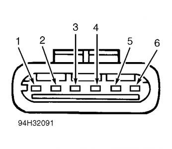

FIG. 2
https://images.2carpros.com/forum/automotive_pictures/261618_2_61.jpg
