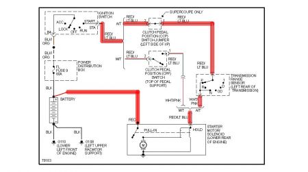

Where is the starter relay located at? Is it under dash in a box?

There's no starter relay in your starting circuit see below-
