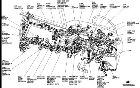

Hello-
my check engine light comes on at startup. I tried taking it to my local auto parts store, but they claim they can't see a place to plug in a reader. So my first question is, does anyone know where the port for the reader is on a 94 ford thunderbird? Any ideas what could be causing the check engine light to come on at startup? I can disconnect the battery, and the light will go off for a few days, and then randomly at startup it will come back on. Engine seems to be running fine. No jerking, stalling, or vibrations that I notice. Any ideas on my problem, or the location of the port for the reader? Thanks.

The Data Link Connector C2012 is located behind I/P, below glove box.

Thank you so much! That did it. Now the code read troubleshooting p0402. Egr system fault. The ecm has detected too much flow on the egr system. Probably cause
1. Egr valve stuck open
2. Failed egr pressure sensor
3. Failed egr valve
now right before this started happen my wife darn near ran it out of gas. Would that have something to do with it? Is this something I can fix/test myself, or should I take it to a shop?

Now right before this started happen my wife darn near ran it out of gas.
It has nothing to do with the fuel system-I strongly recommend you briing it in after you clean out the EGR valve and test the DPFE sensor and it continues-
