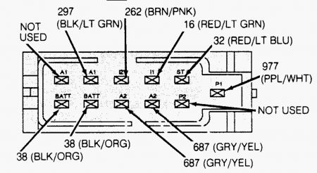

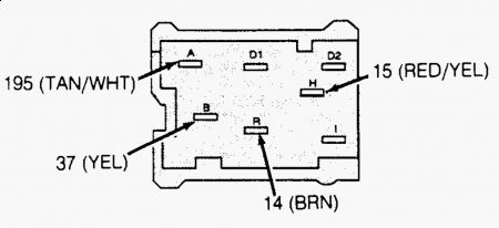

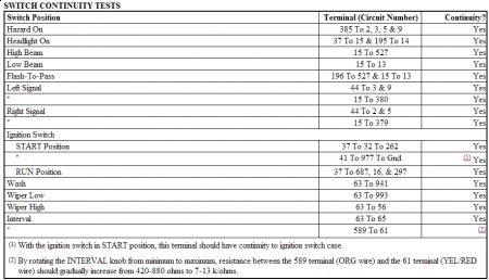

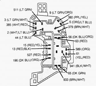

My headlights are involuntarily blinking soon after turning them on. Do you know what mights cause this.
Saturday, September 12th, 2009 AT 10:25 PM
MERLIN2021
MECHANIC
17,250 POSTS
Perform a continuity test on all three switches, start with the mutlifunction, headlight, then ignition switch, table and socket ID is below.
