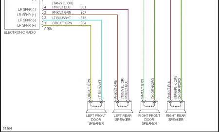

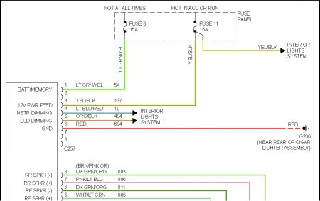

Need to know what wires goes were
Saturday, May 29th, 2010 AT 2:31 PM
BLUELIGHTNIN6
MECHANIC
16,542 POSTS
Just buy a radio wiring harness, it saves a lot of headache..
if the wires are already cut then the wiring diagram is below..
