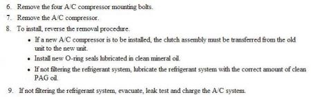

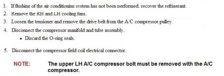

what are the steps to replace the a/c compresser
