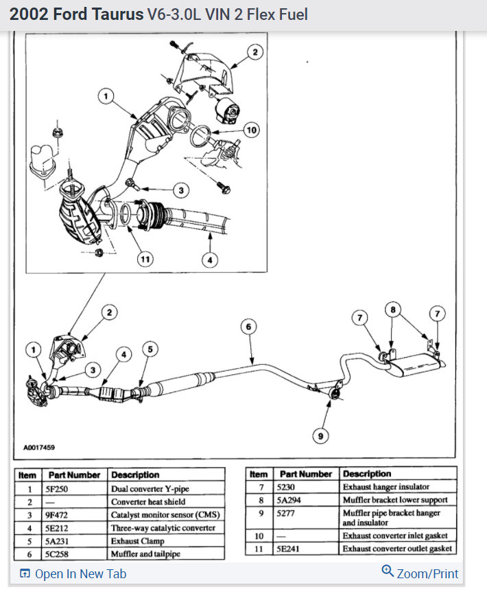

Here is a guide to help you step by step with instructions in the diagrams below to show you how on your car.
https://www.2carpros.com/articles/catalytic-converter-replacement
Catalytic Converter
Removal and Installation
1. With the vehicle in NEUTRAL, position it on a hoist. For additional information, refer to Maintenance/Service and Repair.
2. Remove and discard the 2 nuts and the muffler clamp.
To install, tighten to 40 Nm (30 ft. lbs.).
3. Remove the 2 catalytic converter-to-dual Y-pipe nuts and the catalytic converter.
Discard the nuts and the gasket.
4. NOTE: Clean the mating surfaces of the catalytic converter and the dual converter Y-pipe.
NOTE: To correctly seat the converters, alternately tighten the catalytic converter-to-dual converter Y-pipe nuts to specification.
To install, reverse the removal procedure.
Install new nuts, gasket and muffler clamp.

The Y catalytic converter assembly all you need as far as other converter even if you have it its not monitored and no need to replace it
(which I dont believe you have one )
I " œve always installed a new O2 sensors
with a job like this
yes you have four before and after the cat
if its monitors not getting ready
check if engine reaching operating temp
and also check thermostat and coolant sensor
check and monitor O2 sensors
if one was changed on a bank and not the other in some cases you would get similar codes
should not need to weld any pipes
it bolts to the manifolds and to the rear pipe
