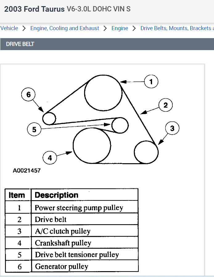

I took the idler tensioner belt off to replace the idler tensioner and I can't figure out how to put the belt back on. Please help

Here is the serpentine belt diagrams you are looking for. Check out the images (below). Let us know if you need anything else.
