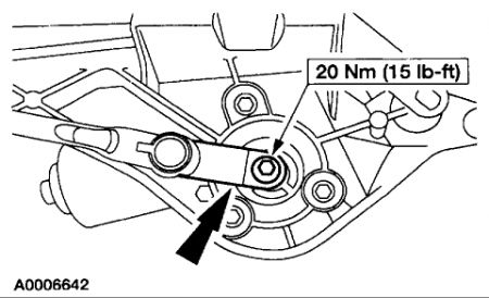

Remove the wiper mounting arm and pivot shaft assembly.
https://www.2carpros.com/forum/automotive_pictures/12900_w_12.jpg

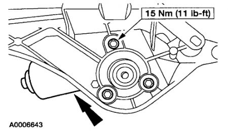

Remove the bolt and the windshield wiper motor operating arm from the motor.
https://www.2carpros.com/forum/automotive_pictures/12900_w1_19.jpg
Remove the three bolts and remove the windshield wiper motor.
INSTALLATION
To install, reverse the removal procedure.
