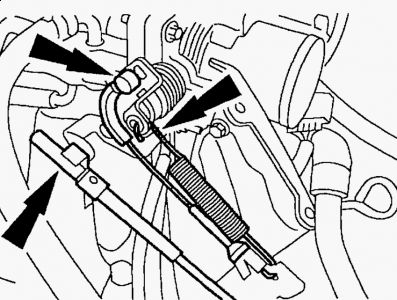

I was pushing the throttle and I heard a snap. Now the throttle flops back and forth. I didnt see any linkage only a sensor. Is there a spring that needs to be replaced?
Saturday, November 28th, 2009 AT 10:24 AM
MERLIN2021
  • 17,250 POSTS
This is the throttle body cable and return spring, one is broken or spring popped off...
