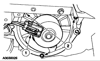

Hi My heater blower just quite how do I check the relay and if bad replace it?

Hello I have provided where the relay and fuse are. Also, you can check the blower by putting 12 volts directly to the plug. I would think your blower is bad.

Blower motor removal REMOVAL
https://images.2carpros.com/forum/automotive_pictures/248015_2_31.gif
Remove pin-type retainers and the right instrument panel insulator.
https://images.2carpros.com/forum/automotive_pictures/248015_3_25.gif
Remove the blower motor. 1 Disconnect the electrical connector 2 Remove the screws and remove the blower motor. INSTALLATION To install, reverse the removal procedure.

that was the problem thanks!
