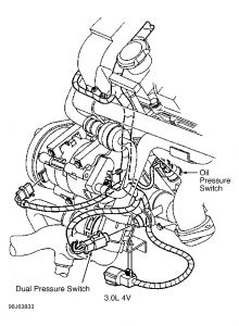

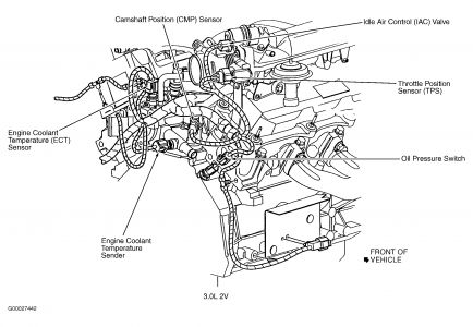

I need help finding the Oil Pressure switch.

See location below:
2001 Ford Taurus LX
Fig. 2: Right Rear Of Engine (3.0L 2V)
Courtesy of FORD MOTOR CO.
2001 Ford Taurus LX
Fig. 4: Left Front Of Engine (3.0L 4V)
