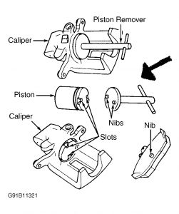

I've been used to using a C-clamp to force 2caliper pistons back in the caliper when the new parts are ready. There seems to be a problem caused by the parking brake locking the piston in the extended position. What do I do to get the pistons back into the caliper? Thanks.. Anton

Hello thanks for the donation .. much appreciated You need to rotate the pistons clockwise with the special tool (see diagram below) hope this helps REAR BRAKE CALIPER & PADS Removal (Continental, Cougar, Mustang, Sable & Taurus).. Raise and support vehicle. Remove rear wheels. Disconnect and plug brake hose at caliper. Remove parking brake cable retaining clip from brake caliper. Disconnect parking brake cable. Remove slider pin retaining bolt. Lift caliper assembly away from anchor plate. Remove slider pins and boots from anchor plate. Remove brake pads and anti-rattle springs. Installation When installing new brake pads, caliper piston must be properly retracted. Using Piston Remover/Installer (T87P-2588-A), rotate piston clockwise until piston is fully seated. Ensure one slot in piston face is positioned so it will engage nib on brake pad. See Fig. 7 . Install brake pads, anti-rattle springs and brake caliper. Ensure brake pads are properly positioned. Clean retaining bolt threads and apply one drop of Threadlock & Sealer (EOAZ-19554-AA). To complete installation, reverse removal procedure. Bleed brakes. See BLEEDING BRAKE SYSTEM . Adjust parking brake as necessary. See PARKING BRAKE under ADJUSTMENTS. Fig. 7: Positioning Piston In Caliper (Continental, Cougar, Mustang, Sable & Taurus)
