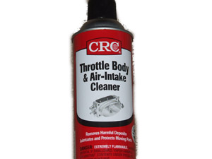

Use only trottle body CRC brand cleaner, Fords use teflon coatings on these and carb cleaners destroy the finish.
Monday, June 23rd, 2008 AT 5:37 PM
MERLIN2021
  • 17,250 POSTS
https://www.2carpros.com/forum/automotive_pictures/62217_CRC_Throttle_Body_1.jpg
Tuesday, June 24th, 2008 AT 4:09 PM
