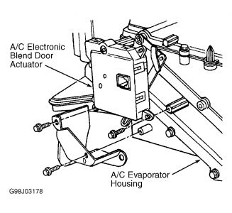

Heater blows cold air, replaced thermo, I think we have a problem with the blend air door not closing properly. Please help?

Check heater hoses they both should be hot
if yes then I would suspect blend door and it need to be checked and or replaced
1.Disconnect negative battery cable. Remove right lower console trim panel from instrument panel. If equipped with center console, remove right, front side panel from console. Disconnect A/C electronic blend door actuator connector from actuator. 2.Remove 4 screws retaining A/C electronic blend door actuator to heater/evaporator housing. Remove A/C electronic blend door actuator.
To install, reverse removal procedure.
http://www.2carpros.com/forum/automotive_pictures/99387_Graphic1_96.jpg
