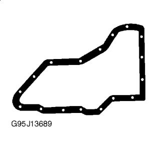

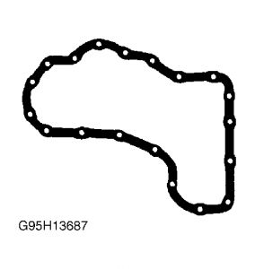

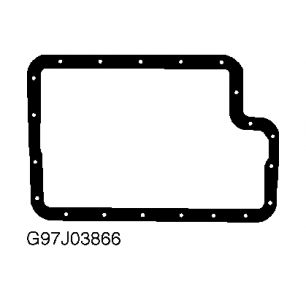

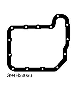

How do I identify what transmission is in my Taurus? It has 3 liter dual overhead cam engine, column shift.
Monday, March 22nd, 2010 AT 12:51 PM
BMRFIXIT
MECHANIC
19,053 POSTS
Tranny oil pan
AX4N
AX4S
CD4E
E4OD
