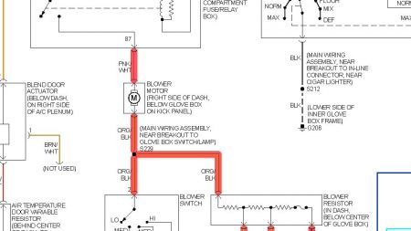

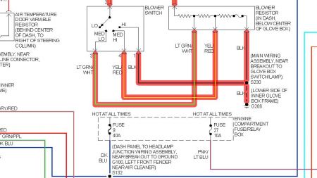

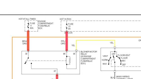

Below is your AC/Heater EWD
http://www.2carpros.com/forum/automotive_pictures/12900_b1_4.jpg
http://www.2carpros.com/forum/automotive_pictures/12900_b2_4.jpg
http://www.2carpros.com/forum/automotive_pictures/12900_b3_4.jpg

Thanks so much! Where do I go from here? What would have caused the short/melted relay terminal? I have read that water leakage in the passanger compartment is common in these cars. Could that have somehow shorted out the blower motor? I took the motor out and hooke dit up to a 12 volt batter. It spun but it really sparked when I hooked it up to the terminal. I only ran it for a second.

At the blower motor the pink and white is your power and the orange and blue is the ground side-
Melted/shorted relay could be caused by an overload too-What relay are you refering to?

The relay for the plower motor in the power distribution block. The plastic in the power distribution panel was melted where the relay pluged in and it has blown about two relays.

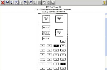

You dont have a description of the fuse locations do you? My brother in law does not have the manual to the car and the top of the fuse cover is missing.

Fuse no.11 and 13 see below
http://www.2carpros.com/forum/automotive_pictures/12900_fuse_4.jpg

Thanks so much! I guess the highligthed ones are to the blower motor. I guess these are the two fuses that go to the 2 "hot" terminals at the blower relay under the hood? I swore I checked all the fuses but I will again.
My guess is the blower motor works but is drawing too much load and that is what is frying everything. Is there a way to check that with a voltmeter?
