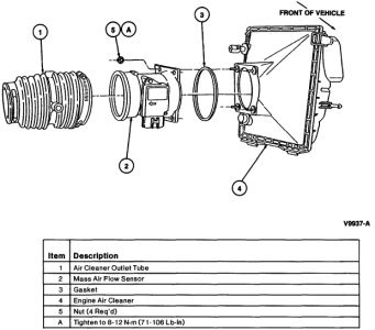

How do I remove the MASS AIR FLOW SENSOR? There is a star shaped screw on bottom right and a small black knob looking thing in the upper left. Removed the screw, how do I remove the other?

REMOVAL:
CAUTION: The Mass Air Flow (MAF) sensor is a calibrated unit. Service hot wire engine element and housing as a complete assembly.
1.Disconnect battery ground cable.
NOTE: When the battery has been disconnected and reconnected, some abnormal drive symptoms may occur while the Powertrain Control Module (PCM) relearns its adaptive strategy. The vehicle may need to be driven 10 miles or more to relearn the strategy.
2.Remove air cleaner outlet tube.
3.Disconnect engine control sensor wiring connector from MAF sensor.
4.Remove four retaining nuts from air cleaner cover.
5.Carefully remove MAF sensor. Discard gasket.
INSTALLATION:
1.Position MAF sensor with new gasket onto air cleaner cover.
2.Install four retaining nuts. Tighten to 8-12 Nm (71-106 lb in) .
3.Install air cleaner outlet tube.
4.Connect engine control sensor wiring connector to MAF sensor.
5.Connect battery ground cable.
6.Start engine and check for vacuum leaks.

So, this is one whole unit? You can't remove the sensor from the meter?
Thursday, October 22nd, 2020 AT 10:08 AM
BMRFIXIT
  • 19,053 POSTS
It can be done, but its not recommended
notice caution above
