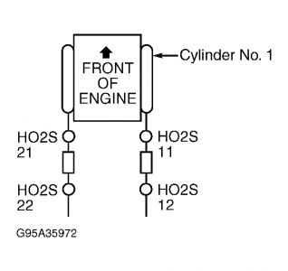

Where does the Oxygen sensor go on this Taurus

O2 sensors located on exhaust system two on each back one before the catalytic converter and one after it
