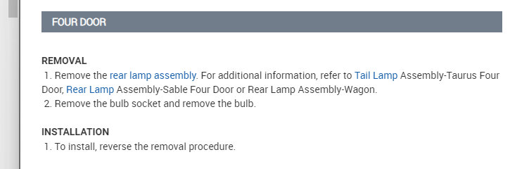

I need to replace the bulb in a taillight. I know I can get the bulbs at a local auto repair place. I don't know much about cars, but I'm trying to save money and am hoping I can replace it myself. The thing is I don't have a manual and am not sure how to do it, or how hard it is. Hopefully you can help me.

I am attaching the process from the manual, but this is pretty easy.
Here is a video of replacing a taillight bulb. Clearly this is a truck, but the process is basically the same. You just need to access the back of the assembly and you twist the connector and the bulb and connector will come out.
https://www.youtube.com/watch?v=rKZ8L1fz84E

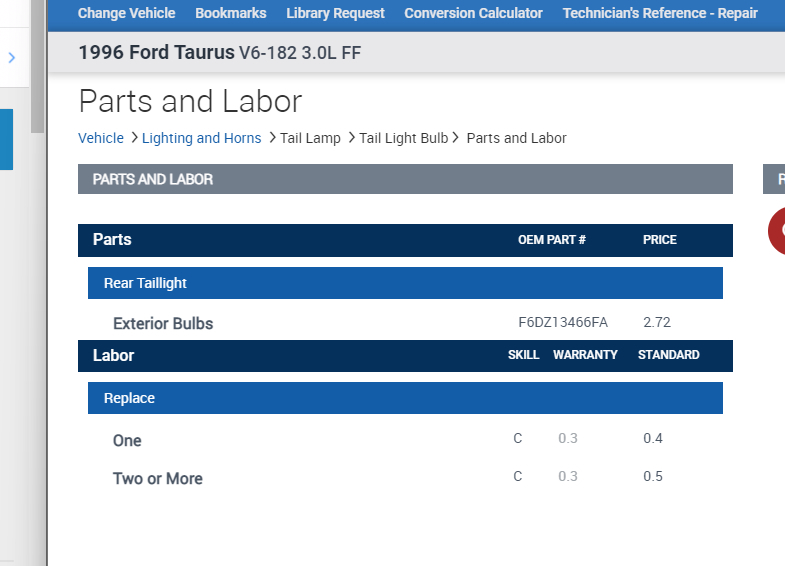

Please see the info from the manual below which is not that detailed but will give more info.
