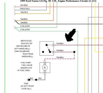

Electrical problem
1995 Ford Taurus 6 cyl Two Wheel Drive Automatic
what does the fuel pump shutoff in the trunk connect to
Monday, January 19th, 2009 AT 10:53 PM
DAVE H
  • 13,383 POSTS
The pink and black wire ... arrowed in diagram ... goes to the constant control relay/module and is power to pump wire ... it also splits and goes to PCM for pump signal .. hope this helps
