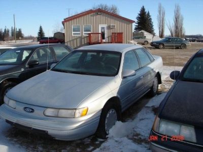

Hi i am buying a 1994 ford taurus and it needs a little work so i was wondering if a coil spring for the suspension is something i can fix my self or not being a 1994 car please let me know it looks like the one in the photo but tan.[img:4e7311a6a0]http://www.2carpros.com/forum/automotive_pictures/233602_sable_1.jpg[/img:4e7311a6a0]

you will need a special spring compressor to do job but if you purchase loaded struts you can do it yourself. the loaded struts come with struts, springs and mounts all together. they are pricey but will make the job alot easier
