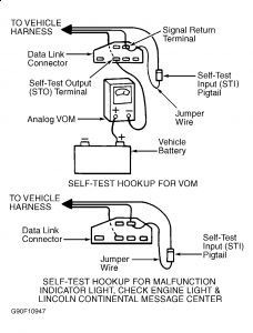

Ok the CCRM (constant control relay module) looks to be what we need to check. This is that box on the radiator support that you unpluged. It holds the high and low fuel pump relays inside. First in you fuse box inside the car you need to make sure that the PCM relay/fuel pump fuse is not blown, it should be 30 amp. If that is good then you need to use a digital mulit meter and make sure that the yellow wire and the black and orange wire at the CCRM have battery voltage these wires should be hot at all times. Then check the ignition coil fuse 10 amp in the fuse box. If that is good then check the red wire with the light green stripe at the CCRM for power with the key on engine off. Also here is a diagram of how to get codes with a test light and a paper clip. In the diagram they show a volt meter just use the test light in its place then you will see the single wire test lead next to the main test harness use a paper clip to jump to the signal return term in the diagram then when you turn the key on engine off you should see the engine light do its thing to give you codes.
https://www.2carpros.com/forum/automotive_pictures/249564_Graphic_83.jpg

There are absolutely no codes whatsoever - the light stays off the entire time and does not blink at all. I assume that's not a normal thing.
