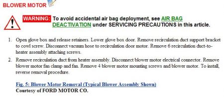

Hi, this car was just given to me and when you turn the blower on for the heat/ac it works but the higher you turn it up the louder and stronger the vibration gets. Do you think this is a problem with the motor or the blower fan?

Hi there,
often a foreign body works it way into the fan and is caught up in the blower fan blades, this will cause a vibration and noise when on, the faster it goes the worse it gets.

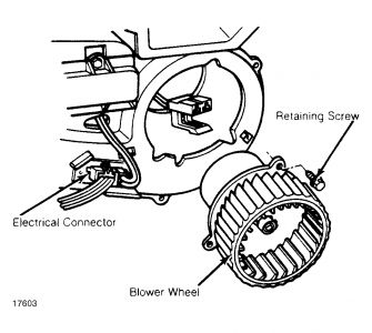

When I can access the data base, I will see if I can send some pics on how to access the blower motor, I can do this tomorrow.
Mark (mhpautos)
Saturday, November 15th, 2008 AT 7:16 AM
MHPAUTOS
  • 31,937 POSTS
Blower motor removal as pic text.
Mark(mhpautos)
https://www.2carpros.com/forum/automotive_pictures/61395_blower_1.jpg
https://www.2carpros.com/forum/automotive_pictures/61395_blower_2.jpg
Sunday, November 16th, 2008 AT 3:02 AM
