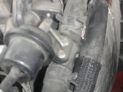

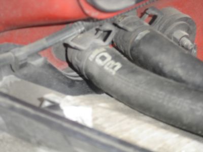

Hello, I have been having a lot of problems uploading pictures to your site. I have several photos taken of the heater hoses, but I can't get them to upload. It took me over an hour and 50?? tries to upload these two pictures. Thanks.

I'm sorry to hear that you are out of ideas, but thanks for your time. Maybe I'll find the source of the noise someday. I'll let you know if that ever happens. Thanks again.
