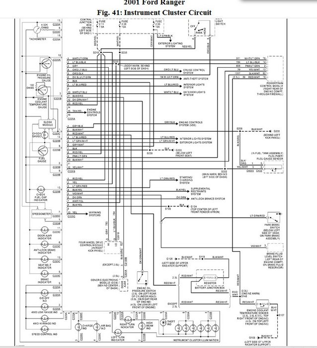

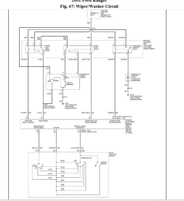

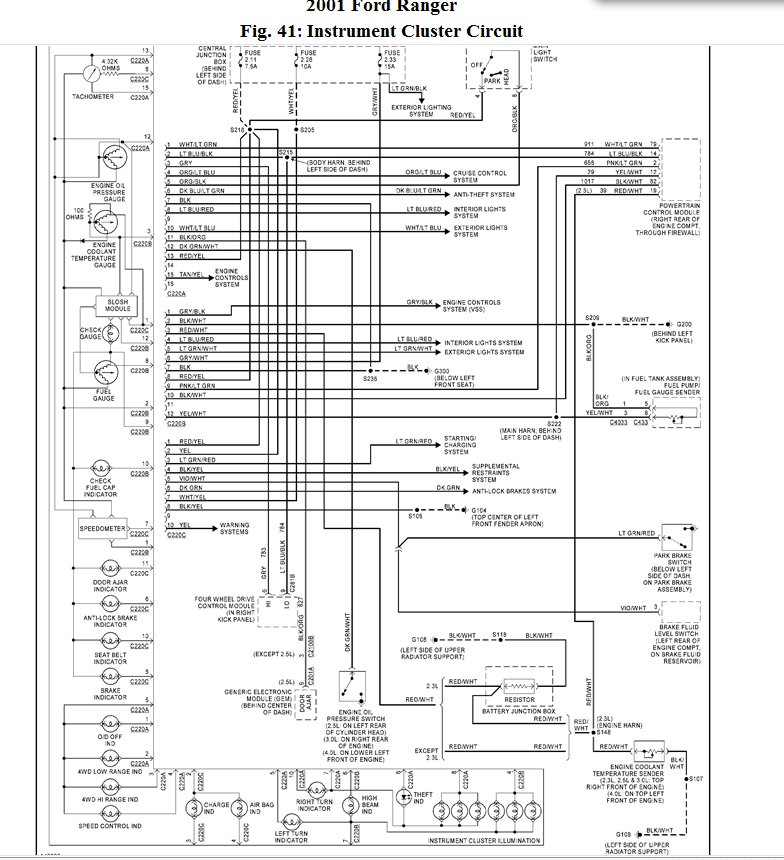

DRCRANKNWRENCH
  • 3,380 POSTS
As far as the speedometer goes check the Vehicle speed sensor on the transmission. Since the tachometer is not working as well and the door chime is not working, I am giving you the instrument cluster wiring diagram. The sensor for the door ajar starts with a switch in the door jamb probably near the lock post. Wiggle it around and make sure that the dinger does not come on if you move it. If it seems stuck or corroded, it may need replacement, also check terminal connections. It shares its wire as part of the instrument cluster harness, which starts as a black/orange wire, see the part near bottom jest left of center, follow wire to junction number eleven.
They may share a common ground so check all ground for good metal to metal, corrosion free and tight fit.
The windshield wiper does not have much to do with any of the instruments other than it may share a common grounds. Ground are denoted by a wire terminating into an arrowhead and tagged with a capital, "G" followed by an number. Compare the two wiring diagrams as I have given you the windshield wiper as well. Check all grounds for wiper even if they are not shared as the switch failing is a common problem on trucks with the age and mileage you have.

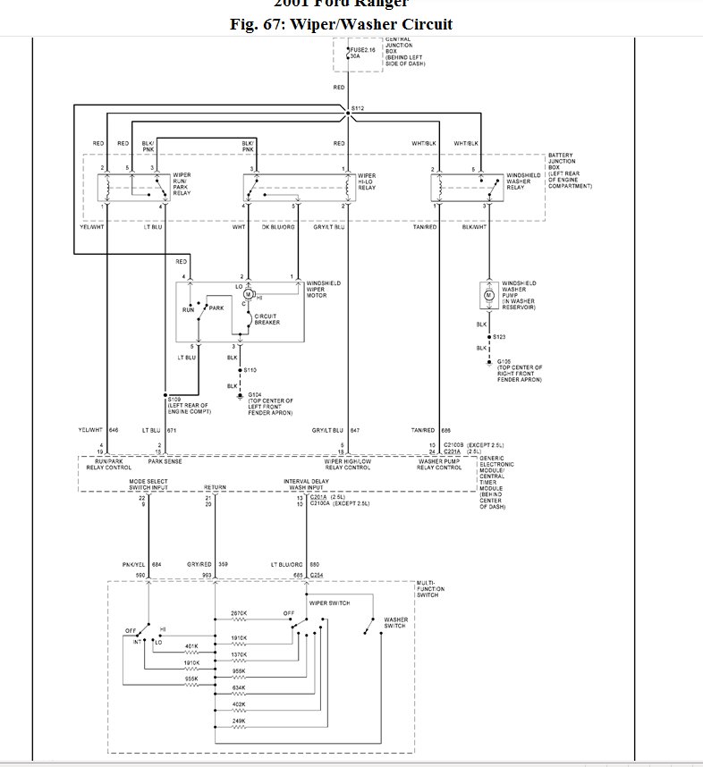

NEWHAR33
  • 1997 FORD RANGER
Four cylinder two wheel drive manual 135,000 miles.
My Grandson and I have purchased and have been working on the truck listed above project, for a wiper switch it has a button someone has mounted on the dash connecting power to the wiper motor. When you turn it on you have high speed wipers only, no Low speed, windshield washers or variable speed. This is a multi-function switch. The headlight dimmer and turn signal part of the multi-function switch is working, and as mentioned the wiper motor is working when the jumper is attached to the high speed wire. I have not checked the washer motor yet. Can you tell me which fuses and relays I should check for the wiper's, and there location? Also, does someone have an electrical wiring schematic diagram for the wipers? Thank's
Monday, June 8th, 2020 AT 11:05 AM (Merged)
DAVE H
  • 13,384 POSTS
Fuse number sixteen in under dash fuse box.
Wiper Hi-Lo relay, in engine compartment fuse/relay box.
Wiper Run/Park relay, in engine compartment fuse/relay box.
+6
DF12345
I have the same problem relays are bad and I used to have to pull the dash fuse in and out for it to work now it does not work at all. I put a new fuse bin and still nothing. Motor and wash works. I need a wire diagram how can I get this or what wires should I test? Need help asap! Please
