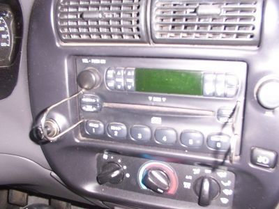

I just purchased a 2003 Ford Ranger Edge. There is a KNOB (that's what the parts list calls it) that has "slipped" lose and fallen inside the dash. It is located on the driver's side on the dash next to the stereo system. At first I thought it was a cigarette lighter assembly and housing, but when I looked at a diagram of it, it calls it a KNOB. I have no idea what it is for (on the opposing side is a 12V outlet), so it must not be too important, but it leaves a hole in the dash. I felt inside the hole and whatever it is, it's there, but in order to pull it back out, I will need to remove the cover from the stereo system. I don't see any screws or clips. Could you tell me how to remove that cover? THANKS!!!

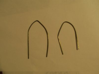

There is four small hole's on your radio's face. This is how you release the radio to pull it out. You can buy a radio removal tool for a few buck's at your local auto parts store, or use a metal coat hanger and cut two half shaped piece's. Store tool
https://images.2carpros.com/forum/automotive_pictures/103836_DCP_0002_2.jpg
Fairracing tool (coat hangers)
https://images.2carpros.com/forum/automotive_pictures/103836_DCP_0003_1.jpg
https://images.2carpros.com/forum/automotive_pictures/103836_DCP_0004_1.jpg
https://images.2carpros.com/forum/automotive_pictures/103836_DCP_0006_1.jpg
