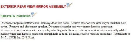

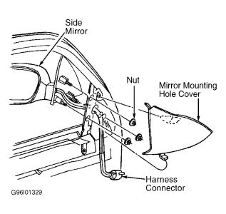

How do I replace a right mirror (manuak style) on a Ford Ranger XLT 4x4
Thursday, March 4th, 2010 AT 3:37 PM
BLUELIGHTNIN6
MECHANIC
16,542 POSTS
Replacement steps are below, manual style is same except will not have harness to remove.
