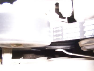

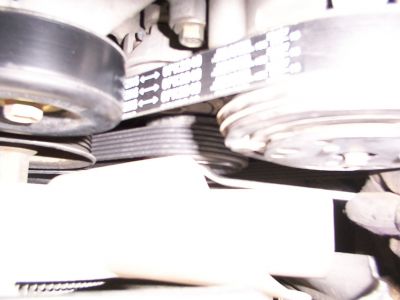

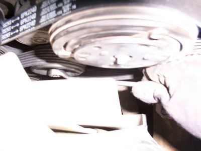

Need to change the serpentine belt and can not find tensioner to release tension. Is there such a thing on this vehicle. If not what do I loosen to replace the belt?
Mar 2, 2008 at 12:48 PM
FAIRRACING31
  • CAR REPAIR CONTRIBUTOR
  • 150 POSTS
Below the A/C and Idler next to the water pump pulley driver side.
https://images.2carpros.com/forum/automotive_pictures/103836_Picture_022_1.jpg
https://images.2carpros.com/forum/automotive_pictures/103836_Picture_024_1.jpg
https://images.2carpros.com/forum/automotive_pictures/103836_Picture_023_1.jpg
Bolt size 15mm
