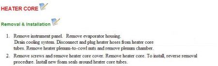

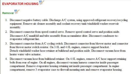

Heater problem
2000 Ford Ranger 4 cyl Two Wheel Drive Automatic
how to replace heater core
Tuesday, February 9th, 2010 AT 5:40 PM
BLUELIGHTNIN6
MECHANIC
16,542 POSTS
Tuesday, February 9th, 2010 AT 11:12 PM
