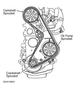

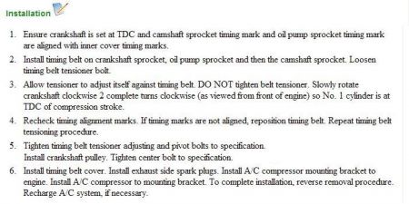

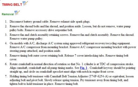

I need to know how to replace the timing

https://www.2carpros.com/forum/automotive_pictures/261618_Noname_1516.jpg
FIG. 1
https://www.2carpros.com/forum/automotive_pictures/261618_Graphic_291.jpg
https://www.2carpros.com/forum/automotive_pictures/261618_Noname2_452.jpg
