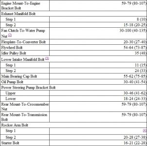

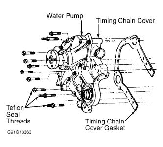

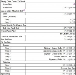

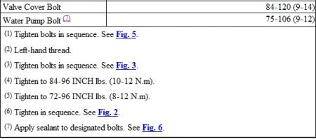

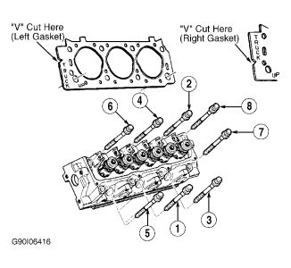

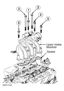

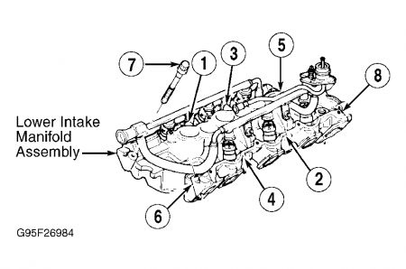

I need torque chart for V6 3.0L Ford ranger engine

FIG. 2
FIG. 3
FIG. 5
FIG. 6
