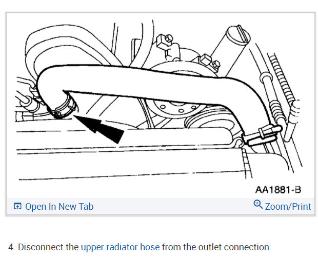

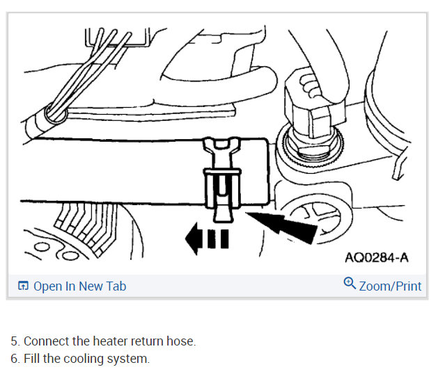

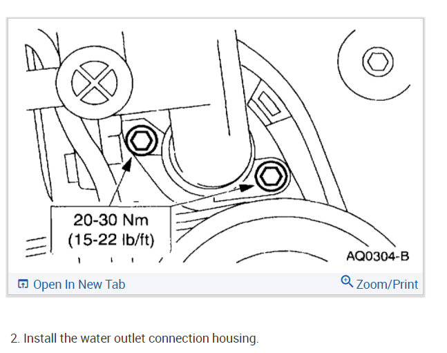

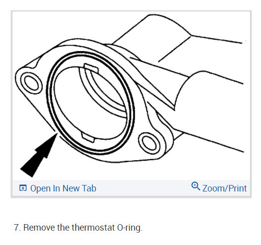

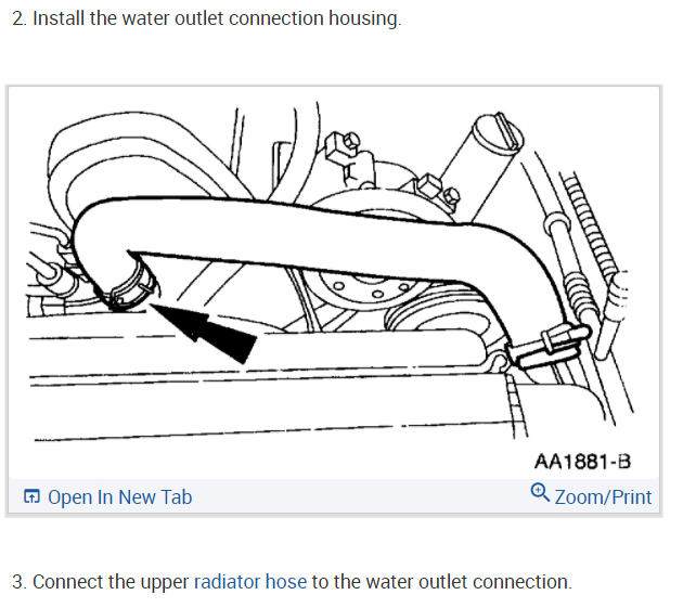

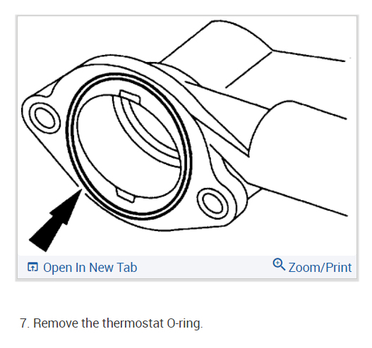

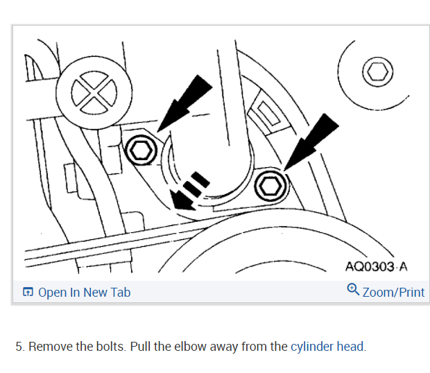

Where is my thermostat located
Wednesday, January 6th, 2010 AT 9:21 AM
SQM
  • 6,383 POSTS
The thermostat for your Ranger is located inside the thermostat housing, which is on upper part of the engine.
The upper radiator hose will lead you right to it.
https://www.2carpros.com/articles/how-an-engine-thermostat-works
You should only work ion the engine when it is cold.

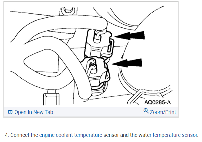

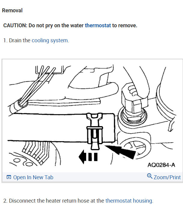

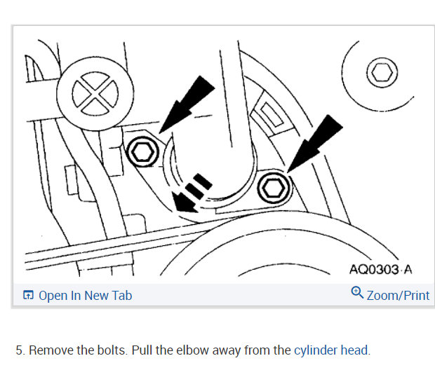

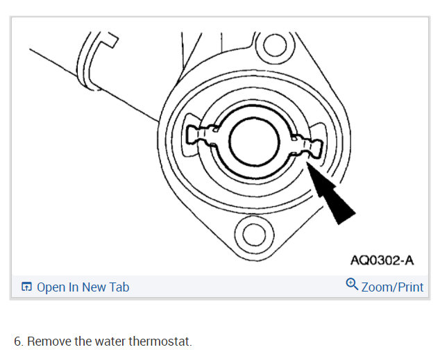

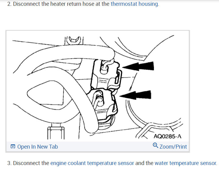

I have attached the thermostat replacement procedure (below).
