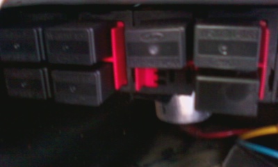

From what i can see the box is full of relays only , here is a picture of it the relay box and the location is beside the console in the middle of the truck beside the heater vents the box was taped up had to get tape off to get inside the box.
http://www.2carpros.com/forum/automotive_pictures/588047_Photo0149_2.jpg
oh the left upper relay in the picture was the problem, i switched out the relays to make sure so i put the new one in where i pulled the other out.

That appears to be just a relay box with common relays that are also used by Chrysler. What I find interesting is how did you determine it was a defective relay and how did you figure out which one?
Caradiodoc
-1
Tuesday, November 2nd, 2010 AT 4:52 PM
GYVER22R
  • 6 POSTS
I kept hearing a clicking noise coming from under the dash everytime the fuse blowed, so I pulled the fuse in and out of #26 quickly to keep it from blowing another fuse to pinpoint where the clicking was coming from, then I found the relay box then touched each with my finger tip while doing that and found the relay that was making the clicking noise.
