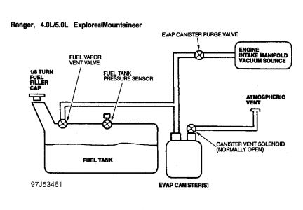

Engine check light-P1443 How to fix this

Check and test gas cap
check fuel lines and tank for fuel leak
check vacuum lines and evap canister
