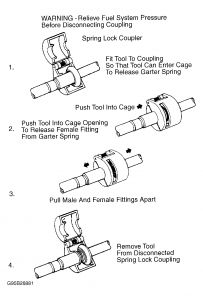

I am trying to replace the fuel filter. The hose from the gas tank I disconnected with no trouble. The line going to the engine is metal fitting and I can not see how to disconnect it.

Hi
Is connection round and can you see like a circle spring inside? If yes need fuel line disconnect tool. Parts house will have under $10
Let me know

KZEIMETZ
The fitting that connects to the out side of the filter is solid metal with the gas hose that goes to the engine crimpted onto it-- I wish I could upload the picture

Look like this
https://www.2carpros.com/forum/automotive_pictures/198357_Graphic_592.jpg

KZEIMETZ
The fitting to the engine didn`t appear to split like the one in your picture but I finaslly found out what the little plastic tool was for. Put it aroung the shaft of the filter and push it into the body on the gas line steel fitting therefore releasing the holding spring inside,

That's what I though it had a garter spring
