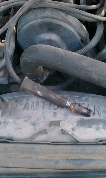

I have a 1994 Ford Ranger with a manual transmission. For a few weeks the car was making a little clanking noise. One morning a loud noise came from under the hood and the car lost power. The engine became terribly loud, sounding like a lawn mower. When driving it home, the top speed was about 5 mph. When inspecting under the hood, everything looked normal, but I can smell gasoline. Any idea of what the problem could be? It's an old car and I don't want to waste a tow to a shop if it's a huge repair. Thanks so much in advance.

FREEMBA
  • CAR REPAIR CONTRIBUTOR
  • 1,152 POSTS
Check the spark plugs one of them may have blown out of its hole. This would kill you power and make a horrible racket.
let me know if that's it. If not we can check further.
Jan 3, 2019 at 10:03 AM (Merged)
STAYLOST
YES! You were right. I grabbed around the engine and it was just lying there. Am I able to screw it back in myself, or should I purchase a new one?

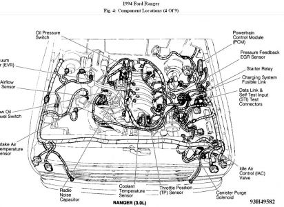

The check engine light will come on. i changed out 1 o2 sensor and the fuel filter and re-cleaned the MAF sensor. I made an attempt to pull the codes but couldn't find the connections per Haynes manual. also checked for possible vacuum leaks.

The DLC is located at right front inner fender panel.

In the Haynes manual there are two plugs to check codes. only one can be located (the smaller one) the larger one pictured in the manual is no where.
