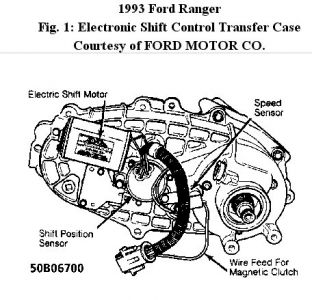

1993 Ford Ranger 6 cyl Four Wheel Drive Manual
when push 4 low or 4high I hear a cilking behind driver seat will ont go in to 4x4 turn on key 4L & 4H lights blink

The clicking is the control module for the 4x4. Take a look at the connectors on the shift control motor on the transfer case. IF they look okay, try lightly tapping on the motor to see if it is just stuck.
https://images.2carpros.com/forum/automotive_pictures/30961_ran1_1.jpg
