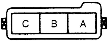

If there is no spark at the coil and there is power going to it, means the coil is bad.To prove that we need to check its resistance.
PRIMARY COIL WINDING RESISTANCE
Detach the coil pack wire harness connector.
Connect an ohmmeter to terminals A and B and record the reading.
Connect an ohmmeter to terminals C and B and record the reading.
https://www.2carpros.com/forum/automotive_pictures/46384_0900c15280260f9b_1.jpg
The resistance specification is 0.45-0.55 ohms
if any of the readings are not within specification, replace the coil pack.
