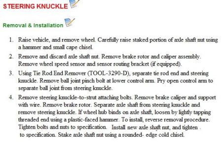

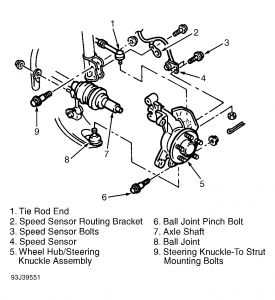

how do I take off a spindal off the wheel, dont know how to take the nut off to get to the hub bearing slash spindal
Thursday, March 11th, 2010 AT 4:57 PM
