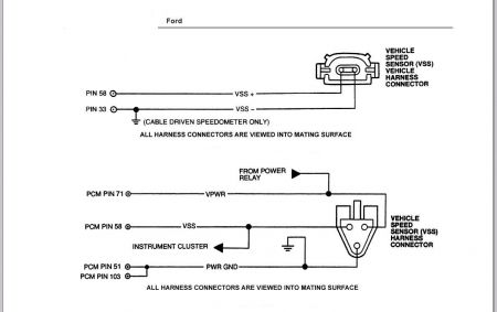

My speedometer stopped working - how do I fix it - is it a cable or sensor or electronic?
