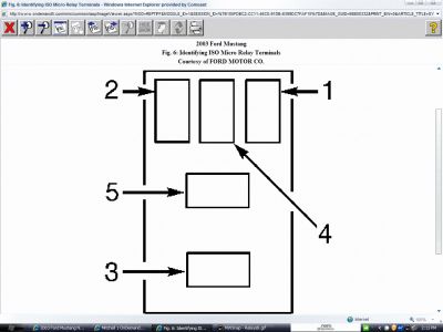

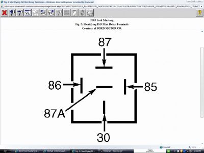

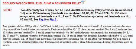

Next you'll need to check the CCRM, both the fuel pump relay and the PCM Power relays are built in to the CCRM, pull it out and check for any burnt wires or bent pins...

I pulled every relay and tested it with an ohmeter and gave them power to verify they are all operating properly.
